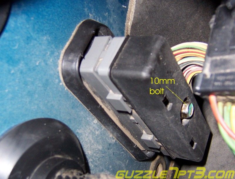

Im finally ready to put my order in and I cant find the PCM code. I read it was below the master cylinder but all I see is a bunch of wires. So does anybody have a picture or a detailed description of where its at?

This is the connector you're looking for.
http://www.guzzle7pt3.com/pics/dpt/pcm_plug.jpg
The tag you're looking for will be on the OPPOSITE SIDE of where the above picture was taken.

Thanks man. Im in the process of getting that bolt out now. Do I have to unplug andything? Or is that 10mm bolt holding one big plug in?
cleatus12r Thu, May 13th, 2010 02:43 PM
The bolt just holds the connector in. It won't come all the way out of the connector, either, so don't get frustrated. You'll feel the threads "clunk" when the bolt is out of the PCM threads.

Thanks Cleatus. I got it out and got my order emailed. Really looking forward to the new chip.
