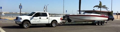

Pic of the trailer:

Anyway, glad you posted a picture. I suspect your trailer is 8 feet wide (standard width). Looking at the picture, it might be 7 feet high? (Box height, and 1 foot off the road?).
Now, with a class IV trailer tow package, the frontal area limit is 60 square feet. If your trailer is 8 x 7, you are at 56 square feet and very close to the limit.
Your tires have a 33" diameter (unloaded). If I were to mount your rims and tires on my truck with its 3.73 gearing and 32" tires, it would reduce my effective gearing to 3.62. I don't know what your stock tires were, but it's clear that your effective gearing is now much less than 3.55.
I'm guessing the empty weight of your trailer is 3-4000#?
In any case, I think you are very close to the tow limit of your truck. If you can afford it, changing your axle gearing to 4.10 would make towing a lot more enjoyable. (Both axles if you have 4WD).
